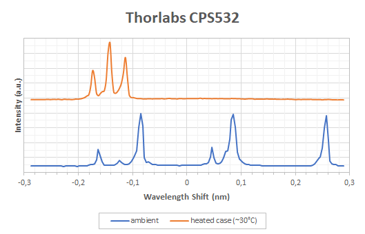

All lasers have some longitudinal modes distributions which depends on their current and temperature. For instance, the default Thorlabs CPS532 that I have1 has the modal distributions shown in Figure 1.
Illustrations of Laser Modes
Figure 1 - Modal distribution of the CPS532 laser at two different temperatures
At ambient temperature, the laser has three distinct modes spread by about 0.4 nm. But at a higher temperature, here 30°C, the laser modes distribution change to a much narrower bandwidth of only ~0.1 nm. Multimodes lasers will typically produces peaks dedoubling, as shown in Figure 2 with iso-propanol. To avoid peak dedoubling, the slit is increased to a size such that it smoothes out the multiple peaks but the overall consequence is to blur the spectra.

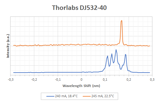

Some lasers, such as the DJ532-40 illustrated in Figure 3, have operating conditions where only one mode subsist. These lasers are called single longitudinal modes lasers.
Single Mode Laser
Figure 3 - Example of single-mode laser
