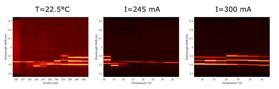

Operating a laser might not be trivial. Depending on the exact temperature and current you may experience either single or multiple longitudinal modes which can affects the performances depending on your slit size and sample type. This is illustrated in Figure 1 where you can you can observe the effect of both current (at a fixed temperature) or the effect of temperature (at two fixed currents) on my specific DJ532-40 laser diode. Each diode may behave differently but the results of Figure 2 should be considered typical for the DJ532-40.
Figure 1 - Graph of longitudinal modes variation with temperature and current
From Figure 1, we can summarize the following observations:
  • Changing the current within the operational range has the most drastic effect. You can see modes appearing and disappearing abruptly as you change the current. Sometimes the effect is progressive, as between 220 mA and 240 mA, or be very unstable, as when you go from 260 mA to 270 mA, or from 210 mA to 220 mA (still at 22.5°C).
  • Temperature change was found to be steadier here but still make a big difference since it can make your laser going from singlemode to multimode as can be seen by comparing 18°C and the range 21-25°C at 245 mA. Note that Figure 1 is basically obtained in these conditions.
  • Changing temperature does however not guarantee that you can alter the number of lasing modes as can be seen at 300 mA. At that current, which is near the nominal current to operate the laser at 40 mW, the spectral signature of the laser almost does not change on the 20-25°C temperature range.
