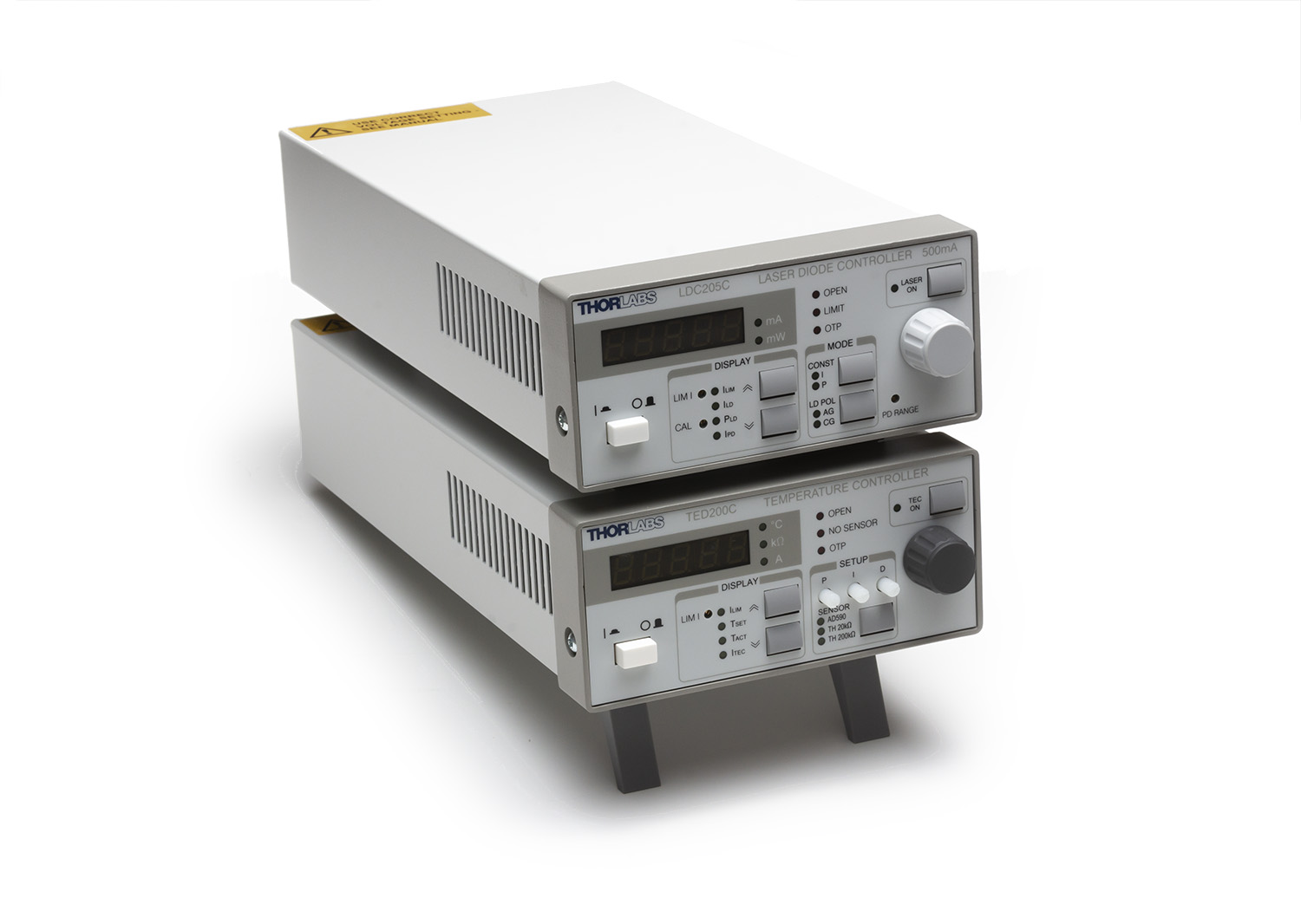

Thorlabs LDC205C & TED200C Driver
Thorlabs proposes both the LDC205C and the TED200C drivers as dedicated laboratory units, as shown in Figure 1.
