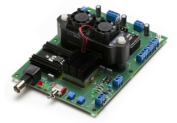

The final assembled circuit is shown in Figure 1. I will guide you step by step to make it.

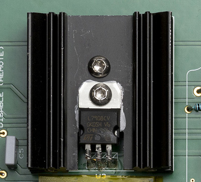

  7. The negative regulator 7908 requires a bit more work as shown in Figure 2:
    Figure 2 - 7908 regulator
    The regulator needs to be attached to a heatsink with one gentle drop of thermal paste correctly squeezed between the two. The thermal paste should make a thin but uniform layer between the two surfaces in contact. Do NOT put excessive paste as it will hinder the performance of the heat transfer. Secure the regulator to the heatsink using a DIN912 M3×4 plastic screw (the screw in the picture is a bit different because I did not have plastic screws at the time of assembly). Secure the heatsink using a DIN912 M3×12 plastic screw with a plastic washer and solder the legs as shown in the picture. Take care that lead do not short-circuit.

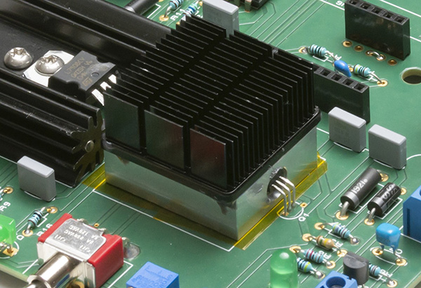

  8. The MOSFET transistor Q1 requires a bit more work as well. You will have to machine (or order) the custom block #2020-20/1 out of aluminum (STEP files and drawings given with the circuit download files). The “APF30-30-13CB” heatsink is placed on top of the block and secured using epoxy glue (I used Scotchweld 2216 but you can use a different one). Thermal contact between the two surfaces is made using thermal paste. Again, the paste should be squeezed to a uniform thin film between the two surfaces.
  9. When assembling the heatsink to the aluminum block, pay attention to the orientation. You should put the heatsink to the opposite side of the small threaded hole at the base of the block.
  10. The MOSFET is put in contact with the block using some gentle thermal paste one more time. It is held in place using a M3×5 DIN913 set screw. Do not force on the set screw. Also, MOSFET are ESD-sensitive devices so you should wear ESD protection at all times during this process.
  11. Attach the block to the PCB using a DIN912 M4×8 plastic screw and bend the legs using a pair of pliers as shown in Figure 3.

    Note that I also added some Kapton tape below the aluminum block. This is mandatory to protect shorting the vias on the PCB.

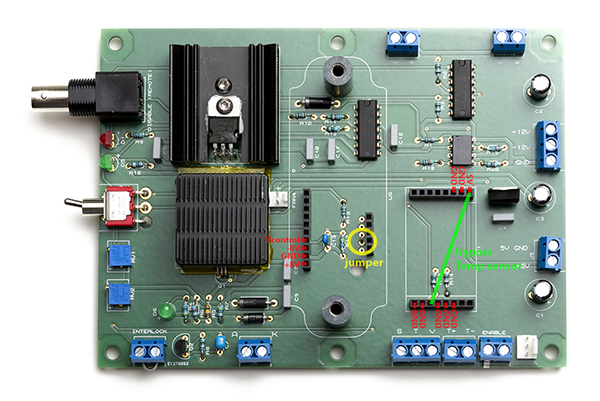

  14. Before testing the LD3000R, first solder a jumper wire as indicated in yellow in the previous image. This is required by the LD3000R for external current operation.

  15. Add a jumper wire to the interlock and connect the key switch to the enable header blocks. Add a jumper wire to bypass the MTD415TE as shown in green in the previous picture.

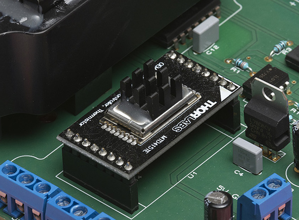

    If all the tests went fine, you can now connect the MTD415TE paying attention to its orientation as shown in Figure 5. Take care that the IC is sensitive to ESD.
    Figure 5 - Testing ythe MTD415TE
    You will notice that I fixed a small additional heatsink to the MTD415TE to be safe. Once again, use a thin layer of thermal paste and secure it using epoxy glue.

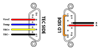

    Before you can test your laser, you will have to wire it to the LDM21 using SUB-D9 connectors. I recommend using 18AWG cables for all power lines and a twisted/shielded pair to connect the temperature sensing part. The circuit has a “shield” connection port to connect the bread of the shield. The cable shield must be connected on one side only (circuit-side).
    Cable the connectors as in Figure 6 (image as seen from the rear side of the LDM21 block).
    Figure 6 - Cabling

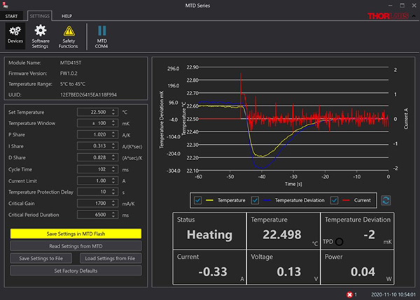

  17. Before connecting the MTD415TE to the circuit board you will have to configure it. This can be done using Thorlabs MTDEVAL evaluation board and a Windows computer. The laser can remain unplugged during the configuration of the board.
    Connect all the wires and the USB cable to the evaluation board before powering it on. Note that for some reason the TEC+ and TEC- ports have to be inverted.
    Install Thorlabs evaluation software and start the application. Connect to the evaluation board and copy the settings of Figure 7.
    Figure 7 - Configuring the MTD415TE
    The temperature should stabilize to the set point without oscillation, as shown in the picture. Note that I recommend increasing the Temperature Window to 250 mK (image shows 100 mK). You may also fine tune your PID settings using the procedure described in Thorlabs datasheet but the values given here should already be a good approximation for your setup.
    Save the settings in the MTD flash and unplug/poweroff the evaluation board.

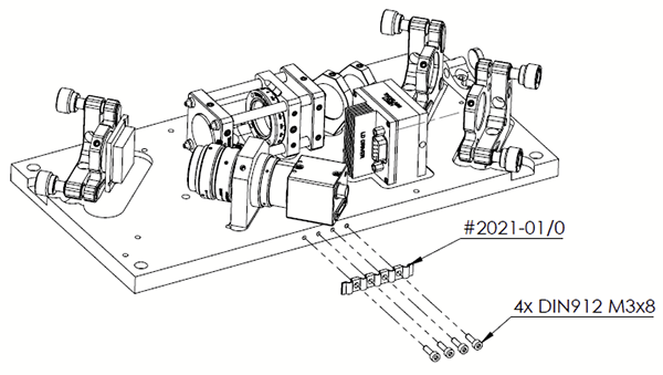

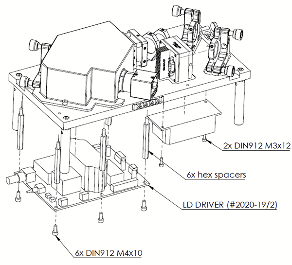

Attaching the LD & TEC to the spectrometer
When using the custom LD&TEC driver, you can install it below the baseplate as in Figure 8.
Figure 8 - Attaching the LD & TEC driver to the baseplate
The cables can be secured to the baseplate using the provided flexure of Figure 9.
