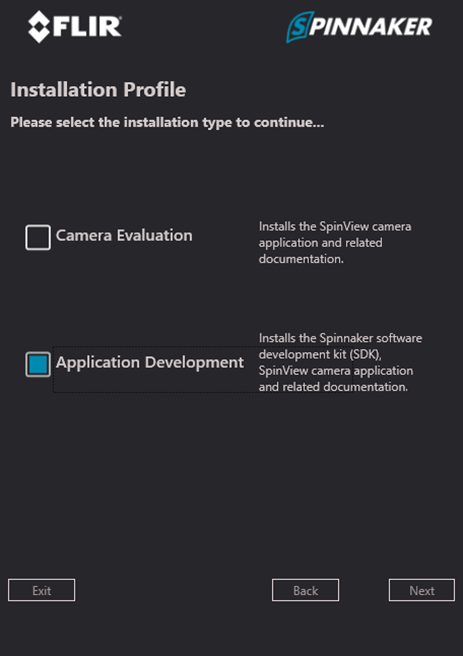

When installing the Spinnaker SDK, select “Application Development”:

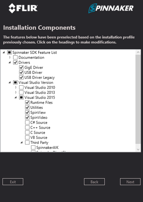

Then select the following modules:
